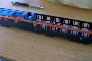

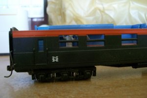

Thought you'd like to see what the interiors look like assembled and in the car. I put the Preiser figures in when assembling, since their legs were to big I had to eliminate the tables on the theory that no one is going to be able to see them when the car is rolling by. I also didn't paint the interiors because at the time I had no imformation on NH interior colors. If you like detail painting, the tables have dinnerware molded on the tops.
I also added some Preiser cooks in the kitchen.
