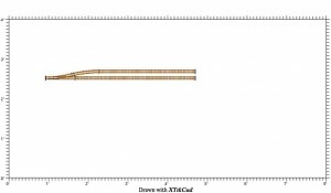

Jambo, the best way to get the tracks parrallel is with the flex track. The piece that comes with the turnout is to sharp a radius. Here's a turnout with 2 tracks spaced at 2"s. Making the curved piece longer will ease the dreaded "S" curve.
