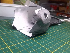

After wasting time, posting the last post, I took some pics, of 1/2 hrs work from last night........... And funnily enough, a little more time is lost, it seems .......:(
I fitted the roof of the nose, no problems ........
I checked the alignment of the spot light mounts across the bottom of fuselage..... No problem ........
I checked the alignment of the spot light mounts from the front of the fuselage..... Problem........!!!!
They don't line up !!!!!!! Fitting the roof, has pulled things true.
Unfortunately, it seems my earlier measurements didn't ring true though....
The tubes in the nose are too high, by one diameter of the tube, therefore the spots would not be straight in that plane .... :headbange::headbange::headbange:
With the cheeks now built up, its gonna be awkward to get the fix done nicely........ But, with a bit of greebling and patience, I think I can fix it relatively simply.
It's just gonna take up more time.... :(

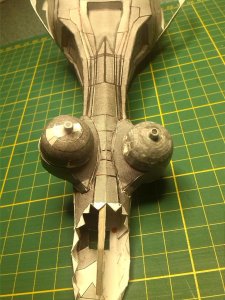

Nice and straight......!
I fixed the problem of the skew spotlight mounts relatively simply. I slotted out the original hole by one diameter of the tube and made up some greebles to cover up the other half of the hole.
Much better...!!
I added some greebles and panels to the sides of the head too.
And once everything was dry, time for a test fit, for the first time, of the spotlights......

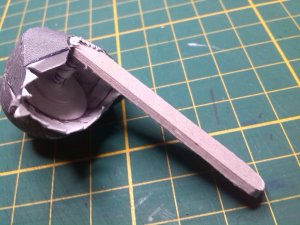

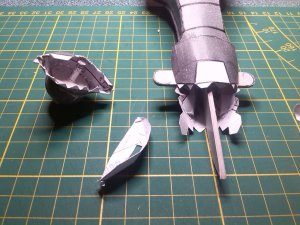

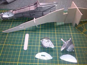

In the meantime, I started working on the leg mounting pods at the rear of the fuselage. These pods will be under load stresses when the model is standing on its legs. I want to transfer these load stresses from the legs, through the pods, directly onto the internal former/frame, thereby eliminating any stresses on the fuselage shell itself. Back in post #180, I showed how I made up the pods. I now have a completed set of two.
After careful measurement, I cut slits in the upper mounting pieces of the pod assemblies and cut corresponding slits in the fuselage mounting pieces, as well as a slot in the internal former/frame. These slits will accomodate a thick cardboard 'bar.'
Things will become a bit clearer in a minute.....

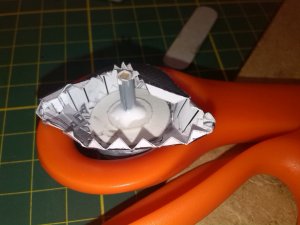

The actual pods that the legs mount to, have a rolled paper tube running through them. One end of the tube will later be glued into the leg. Once the leg is attached, all the stress will be transfered to the tube, instead of the pod itself. I stuffed a thin wooden dowel down the tube to really give it strength! The tube was then pushed through the hole in the pod-to-fuselage mounting assembly.
I then glued a disk to the tube only, which will stop the pod falling off, but still allowing it to rotate.
Once these were dry, I made accurate measurments and cut the tube to length. Eventually, the ends of the cardboard bar will pass through the cut slits and be glued to the top part of the pod assembly. The end of the pod tube will push on the bottom of this bar, thereby transfering the load stresses from the tube to the bar. Hopefully the next pic will clarify this....

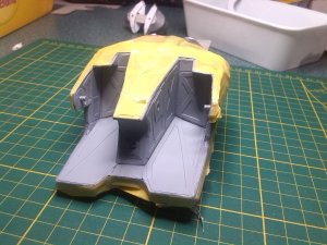

Next up, I attached the pieces on the rear of the fuselage where the wings mount to. I cut a hole for the wiring from the wing tip lights. I left the fuselage open at the bottom to allow access when gluing the wings. The three parts that close up the bottom rear of the fuselage will be added later when the wings are attached, the wiring run and I am satisfied with everything!

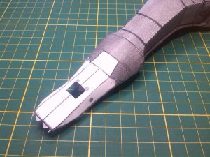

I put the internal former/frame in position in the partially completed fuselage to test fit everything.

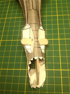

First the bar was inserted through the fuselage as shown in the pics below, making sure everything was square and perpendicular.

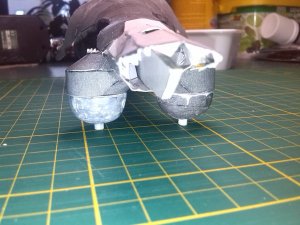

I finished off the assembly of the pods and dry fitted the pods in position on the fuselage, carefully making sure the ends of the bar sat correctly above the pod tube.
I am very pleased with the result........ The mounting is really strong and stable!
One thing I think we can safely say: This is definately a male bird ..... :D :D
