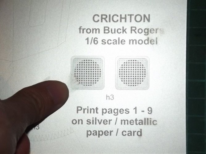

I was lucky to find some suitable silver card sold as single sheets at my local book store. Unfortunately they were not labeled so I can’t tell you their brand or their weight. I bought one sheet first and printed the first page of the kit with an HP inkjet printer. The sheet went through it without problems. However, the ink was fairly wet when it came out, so:
Let the ink dry for at least one day.

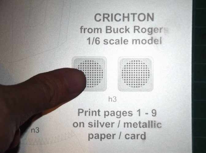

I tested another kind of coated card featuring a different surface. It was a bit coarse and got along with the ink very well. I used it to print textured parts. The ink dried very fast (1 hour) and the result was very convincing. Even the little shading I applied was visible. So print parts pages with a texture on coarse coated card.
attachment.php

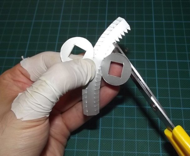

Even if you have let the ink dry for quite some time it is still smudged or rubbed off very easily, especially when you touch it with your bare hands. Things may even get worse when your hands or fingers are sweating. To prevent the lines from being rubbed off wear a glove while cutting. In many cases you don’t need a complete glove, just cut off the fingers (of the glove, of course! ;-) ) and use them only. So the rest of your hand is allowed to breathe and won’t sweat too much.
attachment.php

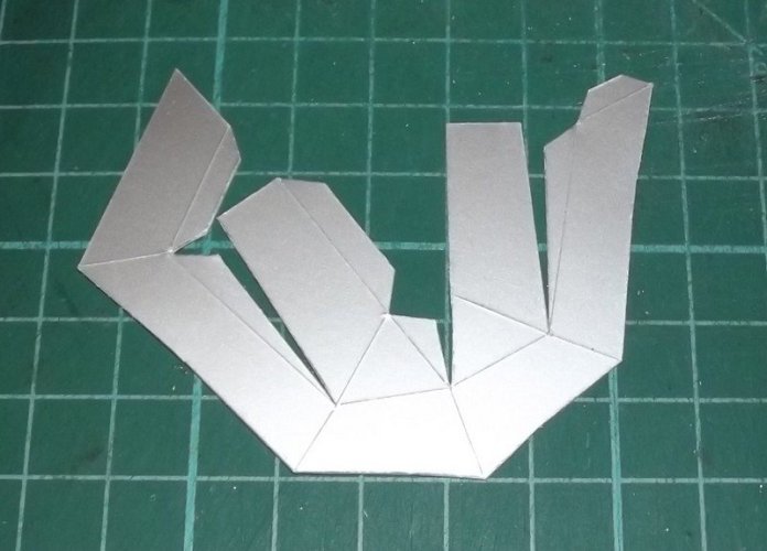

Coated card is a bit stronger than ordinary card. Score the lines gently with your hobby knife as usual.
attachment.php
Pre-shape all parts very well AND very carefully. A pair of tweezers will make work much easier. Roll up curved parts very carefully. Bend them multiple times to a small degree. A cut or a dent will always be visible and should be avoided.

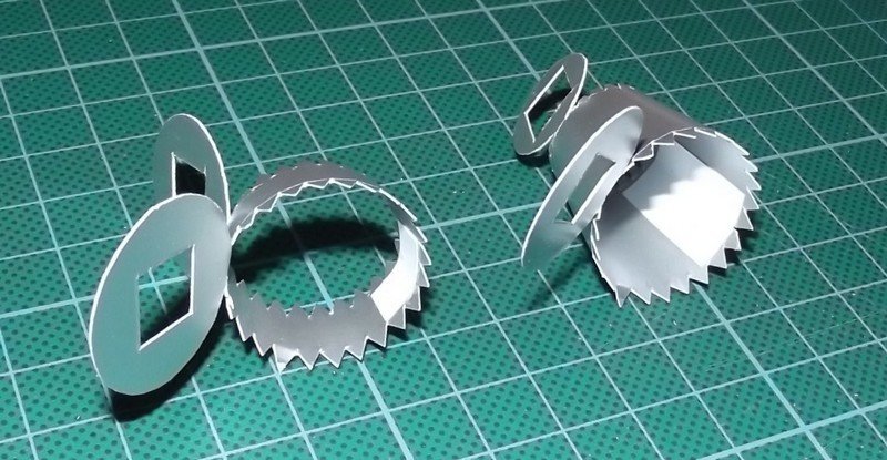

Whenever possible glue curved parts together from behind with a paper strip. Use regular paper to reduce curing time and to prevent the parts from slipping.
attachment.php

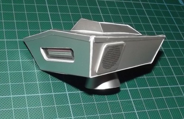

As you can see in the pic the coat on the edges was ruptured during pre-shaping, cutting and assembly. Depending on the over-all look you may leave it that way or use metallic colours to paint the edges. It is all up to you.
attachment.php

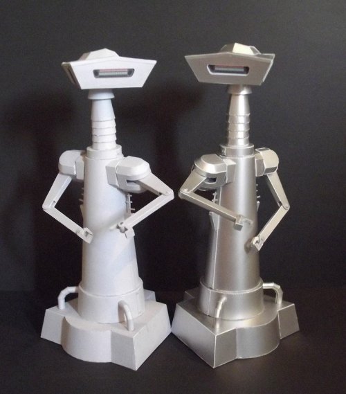

Well then, that’s it. I hope you enjoyed reading this little tut and found it a bit useful. The special care and attention which is required when working with coated card will certainly pay off once your finished model is on display. This comparison shot of the Crichton prototype model made of regular card and the revised model made of silver card clearly shows the remarkable difference.
attachment.php
