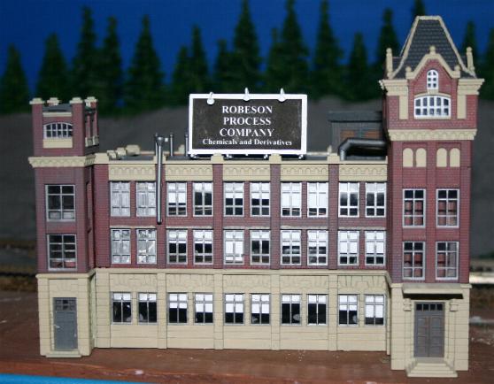

Billboard on the Roebson Process Company. The billboard is from Athearn and the sign is pasted right over the State Stamp that was there. Good deals on these billboards can be found here and there.

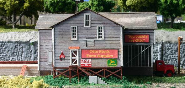

The red and yellow signs on Otto Stock's (get it?) Farm Supplies, including the "Entrance" over the door. I think that "Entrance" is in about 4 point type. The logos are MicroScale decals.

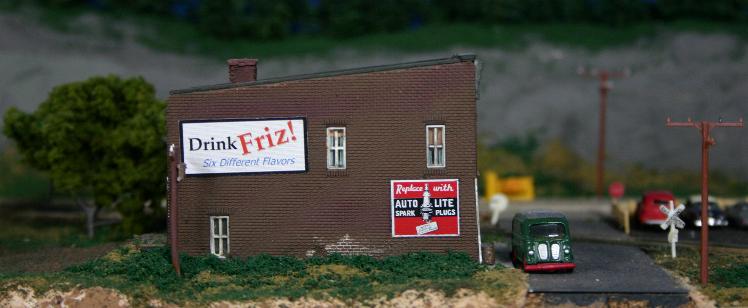

One of my favorites, and if you know your Looney Tunes, you know exactly where the billboard advertising "Friz" comes from. The AutoLite sign is a decal from MicroScale. I think the paper sign compares favorably!
