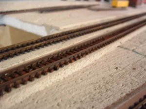

I will take another pic tomorrow, but I use cheapo Walmart brown, and iron oxide-colored spray bombs. A buck apiece, and I do it outside, or with the garage door open. I paint mine before laying them. I masked off the points, and did the turnouts, too. The final touch is a bit more highlighting or weathering, and final touchup on the turnout points--by hand. I'm no Picasso, and the effect is pretty uniform, but the trains will be running long before I finalize the way the track appears, as far as weathering is concerned.
