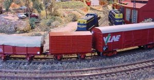

Nick,
I weather my rails and sleepers after I have laid the track, but definitely before ballasting. I use el-cheapo water based artist paint. $5 for a 250ml tub. I use the natural earth colours (burnt umber and red oxide). Mix the burnt umber and red oxide to make a good rusty colour for the rails.
Just slop the burnt umber all over the sleepers using a 25mm brush. No need to be delicate. Remember your ballast will cover all the slop marks. Then use a finer brush and run this along both sides of the rails, using the "rust" mix. (I have an island layout) It's not that time consuming, as you dont have to be that careful and accurate. Then rub the tops of the rails with wet/dry paper to bring the rail back to shiny and good for connectivity. Be vary careful around your turnouts though. Especially where the the turnout rail connects with the fixed outer rails, and getting paint in the switching/slide mechanism.
Woodie

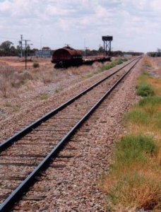

Most examples and the prototype I use for track is wooden sleeper, and the sleepers are never resting on the ballast, but are buried in it. I note with a lot of pics you guys post, that your sleepers are above the ballast. Australian track, the sleepers are typically buried in the ballast.

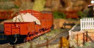

Track Prototype
Thanks Shane.:) Garahbara is HO.
This is a pic of the track protype I try to create on Garahbara. It is at a place called Roto (mid west NSW) on the main standard gauge line from Sydney to Perth.
