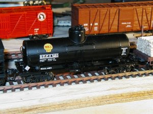

And here's the picture
Proto 2000 8000 gal tank, lettered for Shell. Not the time-saver version (!). Detail Associates wire grabs replaced fragile plastic included with kit.
Took about 5 hours of effort - it is the most detailed kit I have made to date, and I am still new at this!
Andrew
