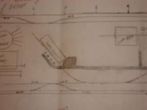

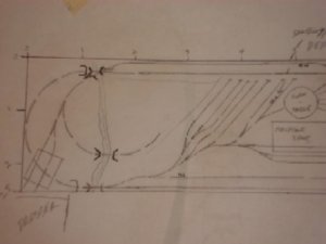

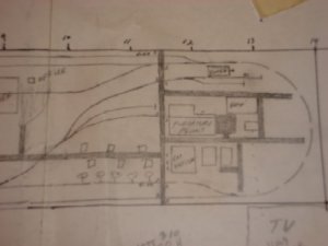

Here are a few pics of our new Conrail track plan. All comments are welcome:wave:

it is a 11 radius and i shoud have said it is a upper part on the left end that looks tight and we plan on running a few SD's on the lower part and a couple GP's and SW's to do switching on top and in the town:thumb:

I always worry when I see that many turnouts in that small of a space drawn by hand. I fear it will not fit as drawn. But it might. I'd try XTrkcad to get a more realistic feel for how it fits.

rr9731's girl said:
This was drawn up by using track template:)
I still worry a little bit, tiny errors in the angles can make turnouts quite different than you expect. The small scale can let you draw things that are impossible.
XTrkCad is free, and has the advantage of letting you print out a full size drawing that you can use when laying the track. The biggest disadvantage is that it isn't the easiest thing to learn, it is not as intuitive as it might be. But doing the tutorials/demos over the course of a few hours gets you pretty competent pretty quick.

rr9731's girl said:
i'll be sure to check it out, this is not our first layout, we've built a previouse one almost like it and had no problems.
It might be fine, the angles going into the yard area just look off to me, but it's as likely to be my perception as it is the drawing.
