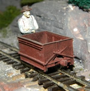

Ok, I have gone up to the RR room, come up with an adaquate O scale figure, and posed him next to an Hon3 Grant line Koppel ore car. the track is HOn3 with code 70 rail. Micro engineering sells Hon3 track with code 55 rail, that would kook tiny in O gauge, especially if you got the weathered track. where the rail is chemically blackened.
As I had mentioned this Hon3 car makes an Ok O scale mine car
