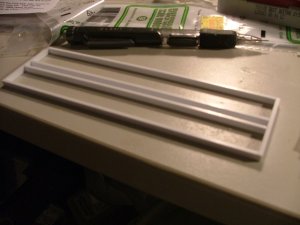

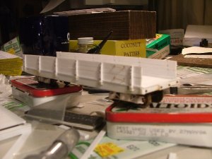

The car is now complete other than the brake wheel stuff...and a coat of paint. I don't know that she'll be receiving any paint...anytime soon...
I've also started a second coal car. The first car was believed to be a UP built type 1 27' coal car...the same prototype as Hartford Products F scale DSP&P 27' coal car...although theirs has the wrong bolster, the wrong trucks, and a couple other small details that are perfectly acceptable. This second car is a UP built type 2 27' coal car...which was the design that served as the backbone of the coal car fleet into C&S days. They came in two different styles...with a 8" or 10" side sills...mine is a 10". Cimarron Works offers this car in Sn3 (and maybe, previously, in On3).

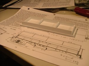

Lastly, here's the frame for my 26' stock car project. Cimarron Works also offers it in Sn3 and previously in On3...while Trout Creek Engineering is coming out with it in HOn3 and On3.

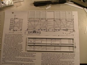

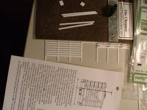

I see there are scale drawings on the table? If so, where did you obtain them?
What are "coconut patties" ?
Thanks Oracle :)
I don't know what coconut patties are...it's just the box my dad kept his On3 drop bottom gondola in. Since the gondola is on my layout, I now use the box for scrap storage.
The drawings are from Ron Rudnick (spark@quik.com). 36 pages of South Park, 30+ of Colorado Central, and a comparable number were their later identities, DL&G & UPD&G...as well as Utah Northern, Kansas Central, and some misc stuff. He also offers a Rio Grande Southern Guide. Some where, I have some John Maxwell plans and a set of South Park connection plans...and misc plans from books...but I prefer the Rudnick guides regardless.

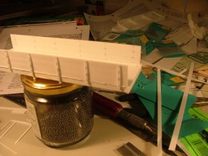

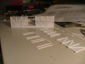

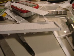

Here's the current progress. One side that just needs the cross bracing, and the other side under construction. I need to get some more 2x4s to complete the cross bracing and start the ends...

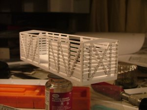

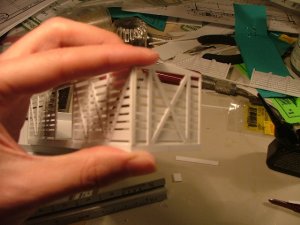

So I decided to do a little more tonight...
I used spacers to make sure the ends were square (they're measured to fit accurately in between the sides.
I then added the braces. With the braces in place, I removed the top board in between the diagonal braces to form the vent.
These ends will still need a little beveling for the remaining 3 joints...as well as the grab irons & NBWs.
