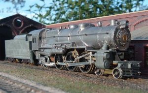

I'm finally starting a long waiting project, a Bowser K4 4-6-2 Pacific aquired as a cast-off freebie. Started by the original owner but never really worked on, I stripped his paint job off with a overnight dip in Pine-Sol.

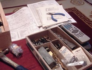

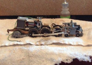

I picked up an old Bowser Reference Guide in a magazine boxlot I was given and found it quite helpful to do the hardest part of the kit---the drive gear linkage. I am so looking forward to running this puppy on the club layout, it easily pushes 2 pounds. One can only imagine what the final drawbar pull will be.

It was a great kit, Jim, almost as easy as a shake the box Athearn freight car. Had her assembled in about 6 hours.:thumb:
Larry, the soldered brass frame, "Penn Line" on the tender shell and Muncy, Penn. address on the box date this kit to just after they aquired Penn Line in '63 but before their move to Montoursville in '65. They went to diecast frames in '88 and I don't even see the K4 on their kit kineup anymore, making it a special kit as I've always wanted one.

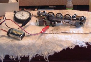

Once the drive train was assembled, I hooked it up to a 9v battery and broke it in for a half an hour in each direction, checking for binds and loosening screws as she went.

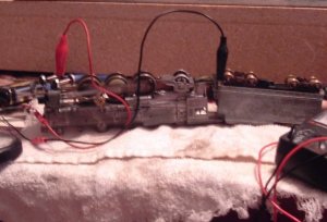

Then I popped the sheel and tender on and applied power again to ensure no bindings were introduced by the new shell and that there were no shorts between the engine and tender. Because I enjoy model trains as miniature machines as well as models, I plan on leaving it unpainted for the foreseeable future, adding K4 details as time and finances allow.

shaygetz
May 2, 2003
3,612
62
www.freewebs.com
Thanks, Wayne, I'll have to catch up with you on the relotor as I'd like to make her DCC---even without the paint as, at almost 2 pounds, it has to be one potent beastie for pulling.

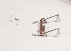

I've owned the kit for over a year and the only reason I took so long to get a round tuit was the valve gear linkage:eek:ops: . Having to assemble it myself was intimidating but actually turned out to be quite easy. You just have to carefully note which side the rivet head goes on and the proper side each piece goes. After only three mistakes that were easily corrected, I had the drive train up and being bench tested in two and a half hours. The kit was finishedn less than six hours and that includes an hour and a half of breakin time. All in all a sweet kit:thumb:

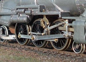

Ed, all six wheels touch on the K4. What you're experiencing was a concession made in the early daze of our hobby to get large steamers to go around the tight curves on most folks layouts. Flangeless drivers (blind drivers would the correct term)were used on real railroads for the same reasons modelers use them. Some model makers even gave you both blind and flanged to give you the option to chose yourself. That they don't touch was another concession---you usually had to file the blind drivers with a slight bevel on both sides. This because the drivers would go past the rail, then drop down. When the loco started coming out of the curve, the driver, being lower then the rail, would derail the loco unless the bevel was there to help it ride back up the rail. To avoid this, model makers would simply make the center drivers slightly smaller so that they wouldn't touch the rail at all.
