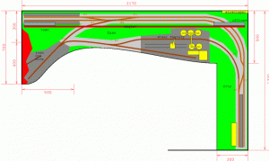

This is my second atemt for a layout, as the first one took just to much room, I am currently destroying it.
I am now building a bookcase (I get the wood tommorow) and on one of the shelfs will be the new layout. And I will use the turnouts I already bought.
All the numbers on the picture are in millimeters, I will convert them to foots and inches here for the people who are not used to the metric system.
The length is 7 foot and the short length on the right is 4 foot. The depth is between 1 and 1.5 foot.
There are 5 stations. on the top left is a medium passenger station which moves passenger trains to an other medium size passenger station in the lower right.
On the side track we have a steel factory in the middle and an iron ore mine in the lower left.
There is a tiny Nn3 track for the mine train running into the mountain. And there is a big track for the crane for loading steel.
The medium sized passenger station should be able to handle 2 large passenger cars with locomotive. A small pendel passenger/loc combination will run on the side line.
A maglev will run from the station on the left to an office block on the right. This maglev will be on a upper level, so it will run above the regular line. I have some ideas how this maglev in N scale can be build, but that is an project for later on.

Hello Matthyro,
Thanks. Indeed I like the big factory and a mine, but I am also worried about not having anough room for a real town on the left side.
I think I have anough room on the lower right for a big town.
I will try and make a real dutch like railroad, towns and industry. There isn't much material for it, so I expect to scratch build/kit bash many objects. Anyway, with the maglev there, I can also do a science fiction rail road.
I am really looking forward to light up the town and factory for running the trains at night.
which is also why I want to run the set with DCC, so the lights on the train stay on.
Plus I like electronics, so I am going to build the DCC system from scratch.
The maglev would be a very interesting undertaking, altough there are some model maglevs made, I don't know if there is one in N-scale and looks like a real train.
I think I can do something with those super magnets used in the head assembly of a harddisk. and a double row of small electromagnets, with a .... (i forgot the name, but it measures magnetic fields) for negative feedback, which would create a zero magnetic field, which slightly lifts the super magnet above the electromagnets.
Then using LIM (linear induction motor) I can propel the magnet slowly along the track.
This is the theory anyway.

I like that track plan, switching layouts are very interesting. I'm actually changing my layout now to incorperate more switching.

Hello,
Switching layouts are indeed interesting, I first had thought of making a loop, but it takes so much room. There aren't many loops in the real world either.
