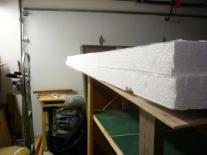

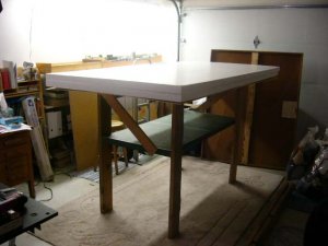

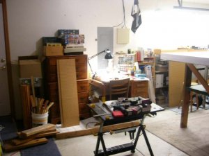

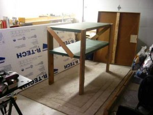

How firm a foundation
Here are some pictures of the framework and 'train room' prep.
Here's the framework for the layout (or any other layout I'd want to put on there) made from the former 'ping-pong' shelving...and even some bracing that used to be legs on a layout table from my childhood N-scale layout.
Two sheets of 2" foam on a 1/4" sheet of lauan. I'll be cutting them down from 4x8 to 4x6.
Behold the throne of greatness, from which awe-inspiring modeling is soon to flow! Okay, well, maybe not exactly a throne, more like an old library desk swivel chair. But it's getting there. The drawers are filled with kits both completed and unbegun and in-between along with train videos - prototype and model.
Finally...notice how the ply is sagging and warping! Oh no! But see how the foam is absolutely rigid...hmmm.
You may be thinking the 2"x6" studs are overkill for a 4'x6' layout made of lauan ply and foamboard. Heck, even after I add all the track, scenery, fascia, structures, etc. I bet the layout itself will weigh less than the framing! Well, you'd be right in thinking so. But I built the lower shelf high enough to clear the big 'ole shop vac and other large items and gained the storage space of the shelf itself for layout building supplies...probably where the scenery stuff will live.
What's more, I built it all with lumber I already had. I used a hand-saw to shorten the studs to make the legs and a power drill to drill pilot holes and drive the screws. Only had to buy the foam and lauan ply (and some foam panel tube adhesive), and it's probably the last purchase I'll need to make before I get trains up and running.
Next step...cutting the baseboards to size (with a carpet knife) and laminating the layers together.

Galen:
What's the temp like in your "office"? I insulated my garage last summer, and even in the winter, it get darned cold. I couldn't think about working out there.
