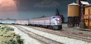

Acrylic Matte Medium dries more flexible therefore less noisy...somewhat. What we use at the club for ballast is sifted traction sand straight from the sanders on locos at Flomaton Yard in Alabama. You'll find piles of it everywhere in a yard and, of course, don't do this w/o the yardmaster's permission. It looks great...

Traction sand Ehh! I think I saw some of that around the yard. Never thought of it. Think I'll mosie on down there. See if the CSX is sitting there. Remember seeing it near the track. That pic is terrific. Looks great. Acrylic Matte medium stays flexible Hmm. good tip. Thanks Bob.Now I gotta see if anbody is at the Yard. Last Time I was there, The old CSX was sitting there Idleing door wide open, nobody was around. Could'nt beleive it. I was there for about 1 hr. Nobody. Guess they figured nobody would want a dirty old EMD. Hehe Robt. I'll have to take the camera. Get a shot of the thing sitting there running. Ha.

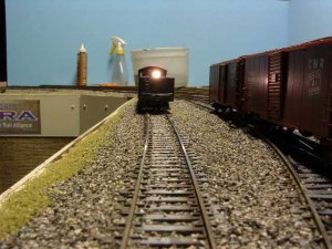

Hey Robin, that looks great, I'm guessing that's your new HO layout? Thought I'd jump on the bandwagon and show what I meant about keeping ballast below tie height. Also the imporance of painting the rails and ties, as you've done. Oops,can't post a pic using quick reply. Next post!

Wow, that's a great shot. that's exactly what I want to do. Everything is exactly how I want it. Color, Ballast size and the flat look without the buildup. Really follows the prototype. If I can do that I'll be satisfied. They are two great pics. Thanks Robin and Bob. Both pics give me a real visual on what to do. Thanks for all the info I know it's going to help tremendously.Gary saw your shots great pics. That is exactly what I wanted to do is keep the ballest as low and flat as I can. These pics and the info are great guides. Robt.

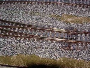

You should not be afraid to put some ballast around the switches just like the real thing. Just be careful and use minimum amounts of ballast. Here is a photo of one of mine. It operates fine with no problems.

Bob, thanks for the tio. I'll keep my eyes out for that stuff. Try it out. Mabe that will keep me out of trouble.David, that advise must have been "hard learned". I'll definately take your advise. Robin great pic. Thanks. I can see what everyone is saying about the mechanisms. I know I would have gotten into trouble. Last count there were some 20 odd switches to do. Hehe-- That would have been the Nightmare Part. Glad I happened on this subject. And everyones advise is priceless. Now I can't wait to get started. If there is any more tips or tricks please keep them coming. One question I have is for some ground cover in spots. I thought that I could add it in after the ballest was set. But would'nt it look like it was thrown on top. instead of kinda growing up through the ballest. At the yard I noticed some green and a lot of stains. Mabe I'm getting ahead of myself. I was just wondering. ( I don't know why I do that. (getting ahead of myself.) See, mabe that's why my wife says I drive her crazy???Hehe. This is a great thread. Hope there's more. Thanks guys. Robt. Oh yeah, Robin is that a medium sized ballest. Just wondering.
