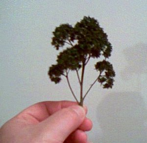

I found some weeds in the No Mow Zone of our yard the other day that make some really nice looking trees. I don't know what the plant is, but it it has seed pods that had burst open. The seeds were like dandelion seeds, and had pretty much blown away. The plants were completely dried out. Anyway, I clipped off several pieces, painted the tops green, and made trees and bushes. Attached is a picture of one of the larger ones.
-Rory

I thought about sprinkling foam on them to make them look fuzzier. But in the end I decided to use them as-is. I made about 30 trees in various sizes, and all it cost me was part of a $1.00 can of green spray paint and a little bit of a bottle of 44 cent acrylic (to cover the green that got on the trunks). You can't beat that! :)
-Rory

That is one perfect tree, Rory! :cool:
There's nothing better than building a little project with things you find around the house!

Rory, that's about as perfect as it gets from nature. The effect is super! I'm looking forward to seeing your 3 sq ft forrest next week Rory!
Any chance of you taking a sample to your local garden centre and getting the Latin and common name for it?
With a bit of luck, it might grow here in UK then I'd know what I'm looking for.
Did you notice Shamus won't tell us the name of his weeds used as Douglas Firs??? I'm sure he has a big supply of them coz nobody ever "made" that many miniatures!!!!! ...:D :D :D

Errol, I'll try to get an ID on it. If the garden center can't help, I'll see if I can find someone at the university. The structure of these branches make excellent armatures by themselves. I'm going to look for some more of these plants, too, in the forbidding, unexplored southeast corner of the yard.
Charlie, the "No Mow Zone" next to my house is actually outside of my "yard." My landlord, being the genius that he is, had all of the trees around the house cut down a few years ago. The guy came in, took the best wood, and left the rest in a big pile. So not only does our house not have any trees around it (it gets HOT in the summer!) but there's a big ugly pile of debris next door. Anyway, that area is too rough for even a push mower, so neither I nor my neighbor bother with mowing it. But, in this case, it turned out to my advantage! :)

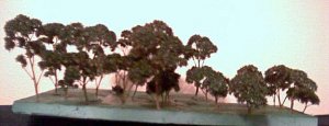

Here's the whole forest shortly before I planted it on the layout:

Bob Collins
Feb 2, 2001
928
86
Council Bluffs, IA
Rory;
It's a little difficult to tell from the picture because the color isn't easy to discern, but my first bet if it has a pod that puts out materials like a dandelion is that it may be some sort of milkweed.
Looks good, whatever it is. Will/have you sprayed it to help it keep its color and consistency?
Bob

Don't forget...one thing that really adds some realism to any stand of trees is one or two dead ones. I bet if you pull those seed pods off that armature you have, you'd have a great looking bare tree. Another good thing to do when making a model forest is to include lots of dense undergrowth around the bases of the trees. If the wiewer can't see through the trees, it adds depth, & the illusion that the "forest" is a lot bigger than it really is.
Otherwise, "you can't see the forest for the trees"! :D :D
(sorry, I couldn't resist that one!)
