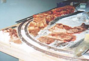

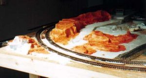

What I do? Get some cheap artist acrylic (water based) paints. $3 a tub (about a beer glass sized tub). or $1 for a toothpaste sized tube. I actually get 1/2 teaspoon and mix it with the plaster, and colour the first layer of plaster a dirt/rock colour. That way, if it chips or cracks a little, you don't get big white bits poking through your painted surface. Get "earthy" colours like red oxide, burnt umber, raw sienna, yellow ochre etc. Those sorta colours, and some black too.
If I have coloured the plaster first (which you can still do, just add another layer), I then water the acrylic paint right down. I mean really really down. I mean 1/4 teaspoon to a large glass of water. (This is called a "wash"). Once the paster is mostly set. (just lightly damp to the touch), I then get a elcheapo 1" brush (50c each), and dip liberally in the "wash" and dab it all over the paster, and let it run down the paster and "puddle" in the crevices and cracks. Start with the darker colours first (a red oxide, or burnt umber), then some yellow ochre or whatever, letting each "wash" dry back to the "lightly damp" stage. Be as rough and ready as you like with this step. Finish up with a "wash" of black. This will then look like weathered old rocks. That's all your rocks done for about $10 at the most on a layout that big. Next, when it's all properly dried out, paint it with white wood glue, and shake on your ground cover (grass etc), and spray with water form one of those misting water spray bottles, or an empty kitchen cleaner spray bottle. You can buy the ground cover commercially, or make your own. Just chuck some backyard leaves and clippings in the food processor/blender and "Churn", or you can dye your own colours using sawdust from somewhere.
Some pics of what I did (on my old layout).
attachment.php
And it ends up like this an old thread of mine and this thread too.

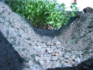

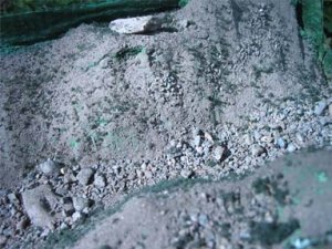

I am no expert at scenery, in fact I have just starting to experiment with scenery on this small little "diarama," if you want to call it that. I was taught that the best thing to resemble dirt is....well... dirt of course! It looks great and it is cheap, ok it is free, and you can't beat free! :D
Like I said, this was an experiment, so it is quite ruff. (Hmm... I guess everything I do is an experiment then LOL) Anywho, after the plaster cloth had dried for a couple days I spray painted it with green spray paint. I used spray paint because that is what I had laying around, instead of spray paint you will probably want to use a dirt colored latex paint. While the paint was still wet, I used a spoon and sprinkled the dirt on top of it and used the paint as a sort of glue. (I had to use a sifter to get rid of all the large dirt clauds first) I then sprayed it with water that had a bit of dish soap in it, I added more dirt until I was some what happy with what I had. Then I sprayed it with diluted white glue and let it dry. After it was dry I added more dirt and sprayed more water and glue on it, I then added the rocks and small amounts of ground foam and sprayed them down too. I now have a sceniced card board box. :D
I have yet to add trees and other vegitation, and when I do my layout I will add some fine ground foam to give it a greener look. (Which I was going for in the first place, but it came out more desert looking and not green) Hope this helps!
