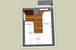

Here is my first attempt at a bench layout for the other room, please tell me what you think and if it will work or not? Also is there a way to stage into the closet?
Cheers
Steve:D

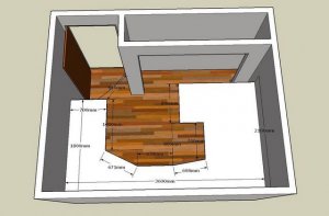

Here is the first room bench layout. Once again your opions are greatly appreciated and needed :thumb: . Is there any chance of a track design similar to the style of the Atlas Suoer Prestzel on any of my layouts or can you guys draw up something even better :D
:thumb:

Steve,
My recommendation (it is only my opinion, so please take it or leave it as you see fit) is that before you try to put benchwork in that you get an idea of what you really want to do. In the case of the bottom picture, for example, the benchwork is really too deep to be able to reach the back reliably. You maximum unassisted reach should be about 24" (600mm) assuming benchwork at about 4 feet off the floor.
I like Cid's suggestion because he had given you a way to reach everything. You will have to include the illustrated loops if you do not want to cross the door and still have continuous running. They take a lot of real estate in such a small room.
Andrew

With the design cidchase drew up you would have some room for industries off the lead into the closet yard. For the yard in the closet, you will need to have enough room to get between the closet wall, and the tracks in case you need to rerail something in there. If you try to use either of the benchwork designs that you came up with, you will have to provide for some access hatches to get to the back of the layout.
