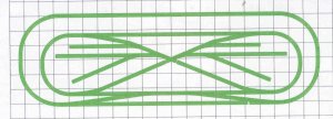

ok this is the layout i want, the outside loop will be higher going up around the turns inside the large hills on the right and left, emerging out of the hills to a long straight with a long wooden bridge, inside area will have ore mine and related ind. and do a small mining town on the other side. would like to use cp line circa 1950s mix of steam & deisels, think there was another line that also would work cant remember which one, so does this look like it will work? jeff

Jeff:
It looks like you will have enough track to get the elevation change you're looking for. It takes about 12 feet in "S" to get a five-inch elevation rise at a moderate grade. I expect "O" is similar. Remember, as you are building the layout, allow yourself the opportunity to change your mind as you discover new possibilities. A "wiggle" or two in your layout wouldn't hurt, unless you have a design goal that demands symmetry.
Using “modular” benchwork is a good idea. Never know when life will ask you to relocate your layout.
Have fun. Keep us posted.
