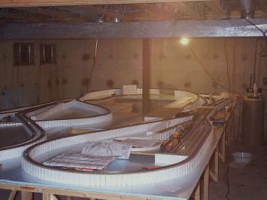

OK OK OK The guilt is killing me I cheated on my inclines I used the premade one by Woodland Scenics they take the guess work out of and its realitivly cheap.They have them in 2% and 4% they also have a wide selection of sub-terrain materials.
Shane
Bob Collins
Feb 2, 2001
928
86
Council Bluffs, IA
The guilt isn't killing me at all and I've incorporated a couple of pieces of Woodland Scenic's foam into my layout :D :D
This is my first layout and I found it great to work with. Is very forgiving and actually you could pin your whole subterrian in place before you ever touch the glue pot :cool:
Bob

Mike;
Do you mean where the two tracks cross the one? What you really have there is a reverse loop going each way. There is a double cross over on up to the left that you can't see. If the train is on the left hand track it loops back around and crosses back over on the single track. If it is on the right hand track it comes around and can come back down onto the left track or can go straight ahead down a spur that runs the entire length of the layout, about 21'. The spur is dead end now as I can't seem to make up my weak mind what I want to put down there; coal tipple, grain elevator, small turntable?????????
Bob

I'll be more than happy to post more pictures when there is progress to show off. Yesterday I spent some time taking out all of the wiring except the drop leads in preparation for installing DCC before I go any farther. Let's see, after I get that finished I'll need to stop for a spell and run a few trains using my DCC and then back to "building." :D :D
Bob
