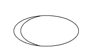

MasonJar
It's not rocket surgery
Oct 31, 2002
5,363
Ottawa, Canada
it is possible to do something like this... but not a true double main. You'd have to break the curve with a short straight section, and that would put you over the 48" limit as Chris suggested.
