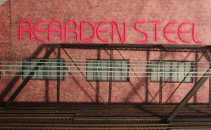

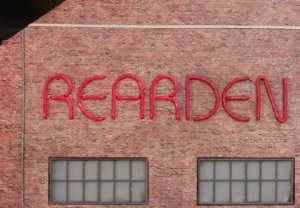

Thanks to all, the electroluminescent wire Jetrock mentioned turned out to be perfect for what I wanted, thanks! Here are a few pics of how it turned out.

Gary, this looks fantastically real. :thumb::thumb::thumb:
I never heard about electroluminescent wire before. Where do you get it and how does it work? And can you bend it to any radius?

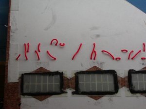

Thanks everybody. Val, yes I threaded it in and out of holes drilled at the ends of the letters which I had printed on the brick paper. Here is the flip side.

I first bought a 5' length and a 2000hz driver. Brightness wasn't what I wanted, so I then bought a 4000 hz driver and the super bright wire. The super bright wire has some orange tint to it, while the other is more red. When I attached the regular red wire to the 4000 hz driver, it too was bright. However, the 5" I bought was a few inches too short for my sign so I used the super bright, which I had bought 6' of. The driver runs on a 9 volt battery, tho I may connect a power supply to it. The driver (there are several to choose from) also has a position for providing a flashing sign.
The radius you can bend to is fairly tight, considering the wire is pretty stiff, and wants to straighten itself out. The letter N in my sign shows the tightest bend you can get. Bend too far and the wire will no longer glow beyond that point. I wound up using a font with rounded letters for this reason.

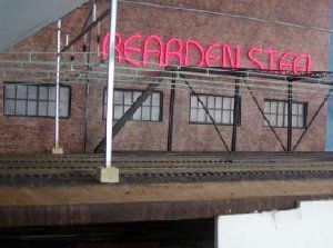

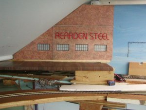

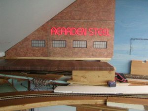

Here are two shots with my under construction 4 track Northeast corridor "module" in place in front of it. Weathering and application of high tension wires are basically what it still needs.
