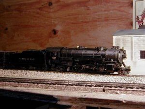

Thanks Twiget. I'll be sure to look for that when I test the loco. Do you have any pics?

OK I am new at this picture posting stuff. Here is my BLI 2-8-2 Heavy Mike just enterning a 18" curve.

Since this thread started with a desire for a Santa Fe mike, I looked at the pic of the BLI USRA heavy mike, and compared it with the mikes pictured in my copy of Iron Horses Of The Santa Fe Trail by Worley. Most of the Santa Fe heavy mikes have two large domes and one small one. The front large dome looks like the one on the front of the BLI model, but is located slightly farther forward on the boiler. The second one looks like the first one and is located a bit behind and kind of straddeling the area where the diameter started to reduce from the center of the boiler. #3283 was the last Baldwin built mike in that class and it has a boiler shape and dome set up very similar to the BLI model. I only have a pic of the other side of the locmotive however, so I don't know how it compares to the BLI. Since it is so hard to find Santa Fe prototype steam in plastic, I think I would be tempted to put #3283 on the BLI heavy mike and live with it. The other problem with it is the typical Santa Fe number boards mounted kind of off the top side of the boiler right behind the large dome. They are a distinctive Santa Fe spotting feature and are not available as a separate casting as far as I know.
