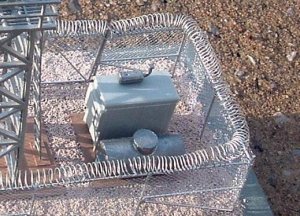

shaygetz
May 2, 2003
3,612
62
www.freewebs.com
I do mine with .020" brass wire and silver tulle (tool), the material used for bridal veils and such. The razor wire is spiral wound .010" steel wire wrapped around a 1/8" dowel. The difficult part is to keep wayward fingers off as the corner can tell...sigh...
