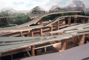

Here's a shot of my Badger Creek in it's early days.
Shamus
