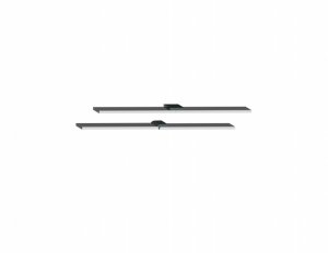

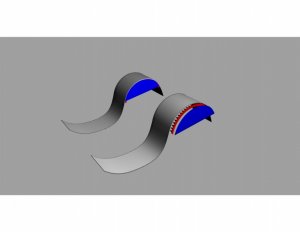

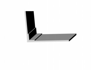

Some models have tabs. They are a pain. I advise cutting the tab and replacing it with an inside tab that is on the same inside plane of the two pieces going together. The pictures below should explain the different ways you can use them. Using a strip to attach another sheet creates gaps, as visible in the example of the two flat sheets joined together. The rest are self explanatory. :)

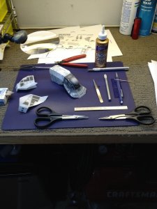

So what have I learned:
1. get a flexible armed magnifying glass. This really helps with making cuts.
2. tooth pick work great for applying/spreading glue.
3. fine tweezers and clamping ones help a lot.
4. lots of light
I will need to invest in colored pens/pencils to hide all the mistakes.
