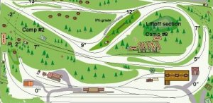

Hi hemiadda2d
Here's an HO plan of mine that fitted into a 10' by 5' space. Should be easy to make an 8' by 4' in N-scale from it. Okay, it's a logging layout, but it doesn't have to be.
Shamus.
