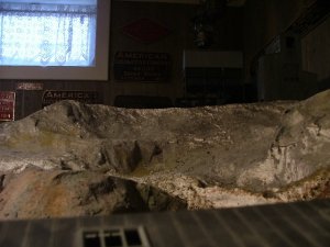

One Layout Picture!
I am slowly building a layout and you can see videos at: My YouTube Videos.
Kind of went overboard with hydro-cal rock castings...I am going to tone down the hill on the right and put the town in that area.

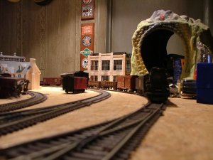

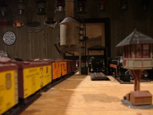

These are HO, but here's a trio. The backshop is not as white as it appears in this picture. The coal mine was also difficult to photograph...with only the black chalk showing up in the pictures. The coal dock looks about like it does in person, and you can see a pair of chalk weathered Silver Streak cars under it.

It's hard to see hey! :D
Cool old laterns by the way! That's awesome!

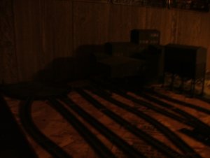

Thanks. My dad used to have the walls lined with lanterns. The walls of the train room were covered with builders plates, padlocks, and other parts of the basement have builders photographs, a bell, and even a whale oil headlight. It makes for a very railroady environment.
The spot lights are missing, which makes pictures of the coal mine difficult. Here's another angle of it.
