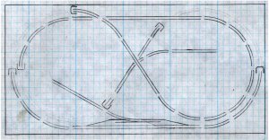

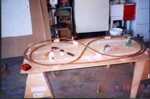

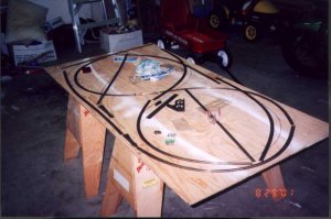

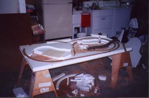

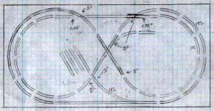

My layout is going to fit into a dinning room table. My wife saw an artical in Model Railroader about a coffee table layout and thought it was a much better idea than using half of the back bedroom for a layout. I convinced her that it was too small and offered no oportunity for switching operations. (24" x 48")
The result is a dinning room table layout 33" x 62" with a glass top that overhangs 7" on each side for a table top deminsion of 47" x 76" (close to 4' x 7') large enough to seat 8 comforatably and 10 in a pinch. the layout section will be a completely seperate drop in. I had to limit the base to 3/8" plywood to ensure less than 6" vertical from the bottom of the base to the top of the trains at the highest point on the layout. I am at 5 & 3/4" now.
If you are interested, I will post my plan and progress pics. I have not yet started laying track.
