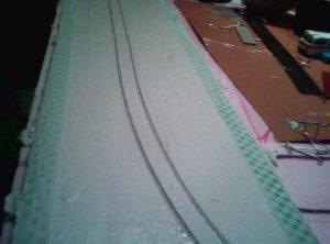

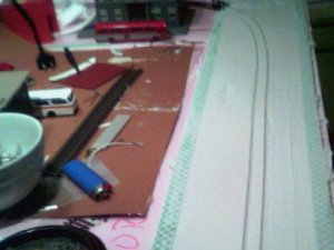

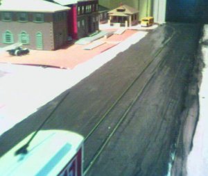

Ok,I did get alot of shopping done early,and I happened to be in Home Depot.....
I reglued the track down last night so it would be dry today.I removed the tpins,built barriers out of double sided tape.The length across is 6" just wide enough for my tool.I tested all trolleys and they made it around numerous times.
I then began the "smoothing" of the speckling.
The stuff "sets" quickly and the more you mess with it,the worse it looks.However,no road is perfect,specially in Boston.Should I mention Type 8's?
It looks alot like the joint compund,and there looks like there will be a need for a second pass,maybe not on the inside but outside of rails.I used and old set of boxcar wheels to make a few passes,and rough it out some. Hopefully with a second pass,it will disguise the ties a bit more.I have decided to use and asphalt color(greyish black) to hide the ties too.
Defintely looks as if the other roads(on both modules) will be in quickly.Then a little bit of sanding,and some paint and I should be ready to ballast the exposed track,and lay plaster cloth.
I don't have to be back to work til Jan 3 so I hope to make some more progress.
Here's some photos.You can see it already looks better than the joint compound did.
http://www.the-gauge.com/attachment.php?attachmentid=24391&stc=1
Thanks for all your help guys.
http://www.the-gauge.com/attachment.php?attachmentid=24390&stc=1

Again,this morning the ties are more pronounced,there are cracks,etc.....:curse:
Its gonna need a second coat.The rails are cleaned and Im getting contact but I am discouraged by the look at this point. A little "sunken".Should I be doing it in smaller amounts? Maybe a small section at a time,sand,clean,lay next section,etc.
Im also considering balsawood inserts for the middle of the tracks.The plastering method seems ok on the outside part of the rails,but in between is the problem.
Anyway,Ive got loads of flexi track and I am not adverse to ripping it all up again. **sigh**
The walthers street system is another way to go,and it's looking like a better option at this point at least on the front "Main Street". Since the module is split at the 4 foot mark I have two sides to experiment on.
The rest of the roads,(not street track) will be speckling.I do like its abilty to be manipulated a but while drying. I'll pick up some road colorings today and I'll lay most of the streets on the module tonight.
The good thing about the trackage on the street id the main part of it faces the front of the layout.Makes it easy to work on once it is reconnected and gives me the abilty to work on it while completeing other sections of the layout that fall behind the trackage.

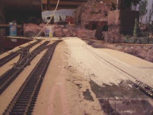

It is in the mixing, must be.
I test the mix using a knife if it slops off thicken the compound up, it has to hold on the knife.
The pics of our road was all done in one go, with no problems.
I use balsa strips about the same hight as the rail , I pin them where the road width will be, allowing for side streets as I go.
Then I mix and pour mix and pour untill it`s all in.
Using a pice of wood the lengh of the street I glide it across the rails balse wood to balsa wood, this will push the excess as I go into the area to do next, have a pan of water to keep the wood clean.
so as it`s drying the top rails are just about showing.
When it`s dry I use a jewlers screwdriver at an angle against the inside rails and a set of wheels to check for contact..
I dont try for a smooth finish untill its been down for 15 mins otherwise you will thin out what you have just done and weaken it .
Hope that rant helps trolleynut :D

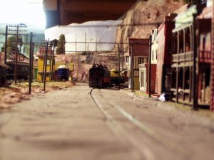

Here is a shot of the last street I did on my old L/O.
The last shot is the finished scene.

I decided to paint it and see what it looks like.The trolleys all make it around!The track needs to be cleaned a little bit better.I will do a second coat later tonight and try to darken it a little.The ties are much less pronounced.I think with a little scenery...hell you may not even notice it.I like the blacktop look anyway.

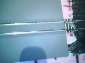

Also went to the hobby shop and found this neat product by Kabri.
Looks like that may work in another section of the layout.Neat product,but they should just mount the rails in for you.:rolleyes:
It's got the cobbles molded in.
attachment.php
They actually are one piece with a spot for the rails score out,but they wont accept the rail. But cut into 3's it will fit:thumb:

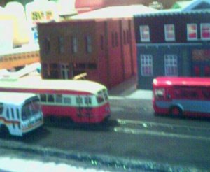

"That bus coming up the street is a fine rare model.The one in the foreground looks to be a APM but I am not sure."(qoute)
That Bus is a GM 1956 era #1500 series TTC # them 1900. painted in TTC colours
Hard to find now if you do GRAB them

On that bus...do you know who manufactured it.Looks to be maybe MEK or Pirate. I would definately grab one if I ever saw it.

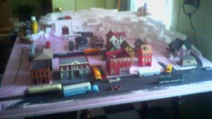

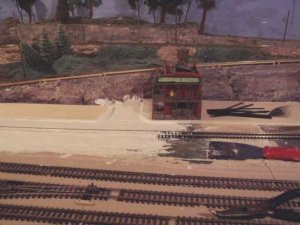

Here's a mock up.The area in the back infront of the portal,is the area I was going to put the bus station in,but I'm afraid with the hieght of the new buildings going in,it may get lost in the skyline. Im now thinking where the small school bus is turning of locating it there.
Alot of the buildings shown will not make it onto the layout.On the far left you can see where the other street trackage will go.
http://www.the-gauge.com/attachment.php?attachmentid=24413&stc=1
