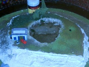

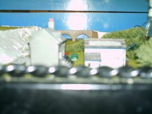

ok all i started my set up was going very good untill i tryed to put some track down with piont motors then i ended up ripping it all back up so is it better to lay track befor and work out where i want motors thei is my first setup any help will be nice after wasting some good time and finding out it was not going to work and way i will stop going on iv riped it all back up and back to a blank start heres some pics of it be for
