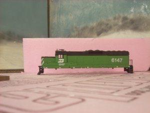

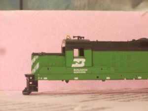

I am converting a BN SD9 into a low hood missabe SDM. I may need help as this project goes along so I decided to make a new thread. But so far I have began to rebuild the cab. I have added one styrene strip and that is as far as I have gottten, but here is the first pic of the project.

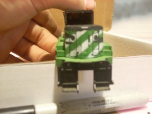

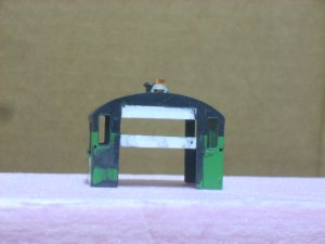

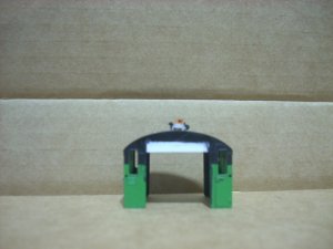

Well I headed down to the basement to see what I could do, and I am almost ready to paint it! i cut the top of the hood off fine and then started to cut out a section of the short hood only to realize the cut was uneven, but I straightened it out. I scrapped of a few details and looked at the prototype pic, I have the wrong fan arrangement on top, but Im not worried about that. I have glued in the front parts of the cab, I just need to round the window corners and add the center divider betweeen the two windows. This will not be perfect by any standards, but for the first one I reconstruct (I will probably do a half dozen or so more) I am VERY happy with the way it is comming along. But you are probably tires of reading, so here are some pics. I also posted a pic of the model before I began.​

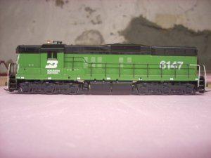

Here is a pic of my models real life brother.

I have been looking at my work, and i do think on future projects I will try using a cab front. When I take off the as is cab on my model, the cab front has nothing because it is covered uop by the high front nose. I could probably use a cab front from almost any SD cab.

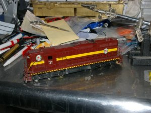

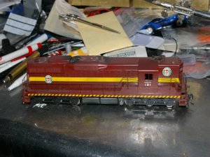

Here's a couple of images of a Trains Inc SD9 that runs on ENDO Trucks - it's got a Tenshodo sibling, No 138, and a Tenshodo Gp7 painted as DMIR 89, though it's slated for a repaint as a MEC passenger unit since it's Non Dynamic-Braked, and has a steam generator.
I really MUST create some space among the Cobras, Daytonas and stationery to work on locos
