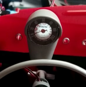

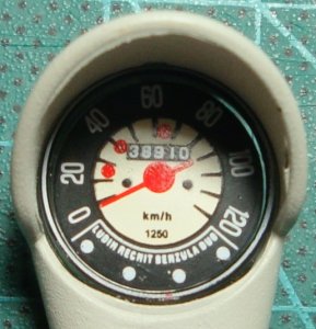

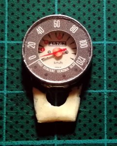

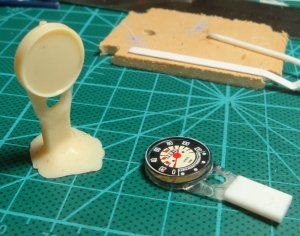

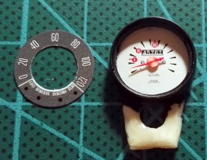

Guess what is the first detail I want to share with you? Not difficult to guess if you know me... instrumentation!!! :)
I didn't like the provided intrumentation. Printed flat on a transparent plastic piece.

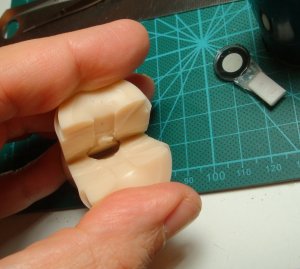

I took the original as a master and duplicated it in resin.

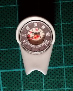

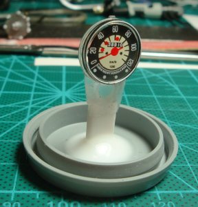

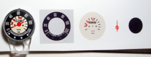

Then I redraw the instrument dials and printed on glossy plastic foil
The original dial was on different levels and I wanted to keep this feature well visible.
And this is the completed instrument panel for my beloved 500!
And, as the model provides instrument backlight, the printed plastic, slightly transparent, was perfect for the purpose...

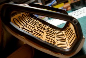

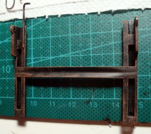

The seats.

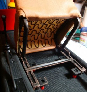

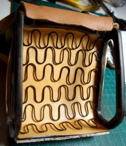

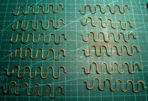

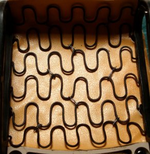

The springs under front seats were a distinctive feature well visible when you reclined the front seat to reach rear places.
The Hachette model represent springs with an ugly print under the seat. Not acceptable.

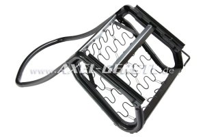

Seat frame had typical "S" springs (this photo is a real spare part)
I realized a wooden tool to create similar springs from a brass wire
The lower frame was properly detailed and provided of the right "rusty" appearance
The new springs were added to the upper frame
And here is the revised seat in place.
12,563
8,059
The seats springs are 100% on the money!! The surface rust looks real, not over done. The light on the gauge is superb, at night, you could make a light sensitive power supply which turns the model's headlights, and appropriate interior lights on, when the Sun goes down. Fantastic!! :)

Love the springs!!! That is exactly how I remember them in all the sports cars I have owned!

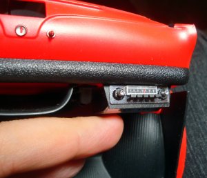

Thanks all my friends! And now comes a chapter where my carmodeler skills were widely used.

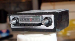

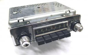

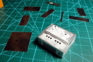

In my car was installed an old radio (it was OLD in '80, now it would be a museum piece) that was removed from my dad's car when he changed his old Ford Taunus for a new (!) FIAT 125 special.
That radio was built before transistor era, so it worked with valves. A real piece of ancient technology. I remember very well that radio with all the black buttons to recall stations (strictly on medium waveband) that once pushed produced a loud "click" moving the little dial behind the front window.

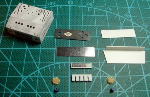

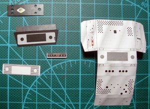

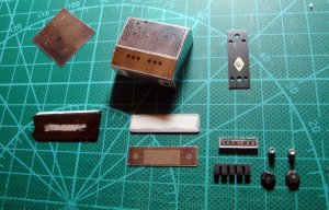

I found a lot of photos of the real radio and decided to build one from scratch (obviously it wasn't provided in the model).
This is the original radio: an Autovox directly from 1962 (just my age!)
I drew the main parts on CorelDraw and printed on cardboard.
Buttons, knobs, the window and some plates was made in plastic.
The assembly still unpainted.
Then, to give a more "metallic" appearance, I printed the body parts on metallic paper.
Here are all the painted parts and the new "metallic" body.

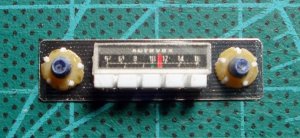

And here is the final assembly. Really identical to the original. I'm very proud of this little model in the model! :)
That's all for today

That is a work of art by itself! Impressive talent. This makes me miss the old "autoradios", these modern never understand. I have a box full of old cassettes and I have nowhere to play them. What you are doing in your "fitito", we call it here, is great.
Reactions: Tonino
10,092
9,717
I'm speechless..!
:bowdown::bowdown::bowdown::bowdown::Bravo::Bravo::Bravo::Bravo::Bravo::Bravo::Bravo::Bravo:
Reactions: Tonino

That is just PERFECT!!! and as you know the old tube radios with the rotary dial will pick up more stations than any of the radios in cars today! Most will skip right over a station... and a lot of them have no manual dialing!!
Reactions: Tonino

Yes Gandolf! You're absolutely right. The good old analogic equipments! :)

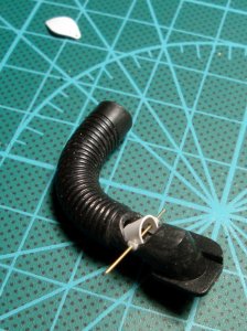

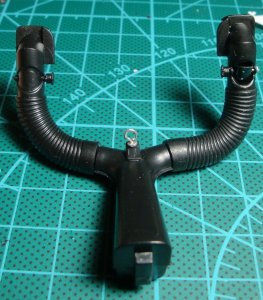

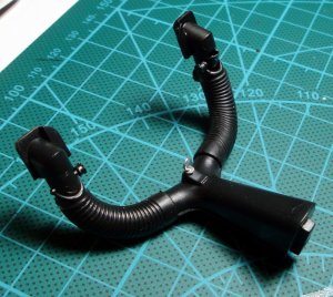

The next part I want to talk about is not a detail easy to explain to someone who has never been aboard a Fiat 500. I'm talking about the heating system.

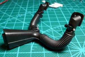

In the 500 there was a simple but really effective heating system: the hot air came directly from the motor and was directed, thru big pipes, directly to two vents placed over front passenger's knee and to the windshield.
A funny thing is that the only command to turn on heating was a little lever (N°3 in the picture) placed just under rear seat. It happened, in summer, that a rear passenger accidentally hit the switch with his heel and suddendly the atmosphere in the car became extremely hot... You can imagine the complaints directed to the poor guy in the rear.

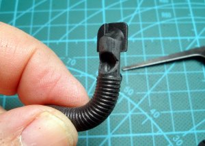

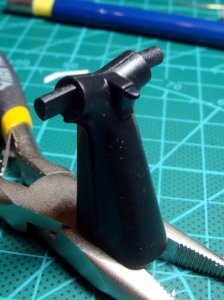

Well, let's come to the model. Every 500 owner remember very well the typical front vent placed above the knee (N° 4 in the picture), it's a very distinctive feature so I wanted to better detail the basic shape provided with the model with a complete and working shutter.
To the right the original part, to the left the part being modified; I started removing with a little saw the portion representing the closed shutter.
Then opened the cavity with my Dremel
added a new shutter made from plasticard and brass wire
And, once painted, this is the new heating vent. Obviously I modified the other one too after this photo was taken.
Please note also the little ring in the center. It's another peculiar 500 feature: the manual throttle command. A very basic kind of "cruise control" ante litteram. The model represented it very basically so I was forced to add another modification...
