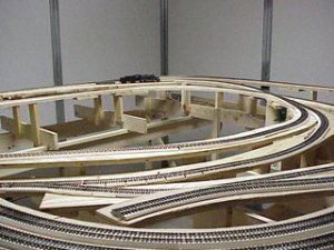

Well, I have asked too many questions, and since it's Thanksgiving I thought I'd share my progress on the layout. I started it in May 2003. I used code 83 and code 70 Shinohara and 7 #6 and 1 #4 turnout onto a siding. My rail is spiked into true-scale pine roadbed ontop of 1/2" ply subroadbed. I used all Tortoise motors in conjunction with DS44 Stationary Digitrax decoders so that I can throw or close all turnouts on my handheld unit (this is fun!). My train room is 12x12 and the layout is 8x8 and I am planning coming off with a 2 1/2 by 10' "L" for more industries and turnouts.
So, here's the photos!
Mastiffdog
Sep 7, 2003
137
66

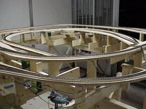

Layout Photo 1
It's in a horse tack room. At least I don't have to feed it.

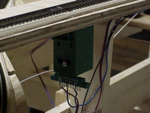

Layout Photo 4
A tortoise ... well worth the extra work to install!

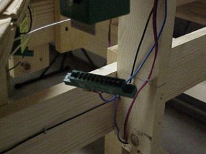

Layout Photo 5
I used "edge connectors" on my switch machines to make soldering and troubleshooting a breeze ...

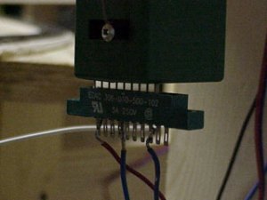

Layout Photo 6
They disconnect so you can solder your leads on the bench rather than to the Tortoise itself. Much easier.

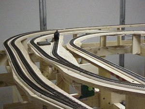

Layout Photo 8

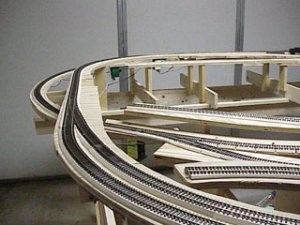

Track is solid and trains run great - using a Athearn Genesis USRA 2-8-2 for testing. Steam gives you the best feedback on track quality. I recommend making sure of this before moving on.

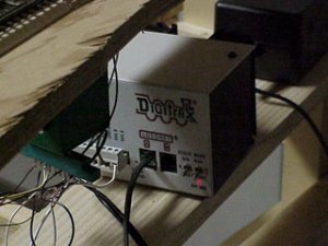

Layout Photo 9
For my rail power I am using the Digitrax Empire Builder. The last photo - thanks!

Hey Dog I think the benchwork and track look great. But I think the comment you made about not having to feed it was a little off, I'm thinking in the long run you'll pay more for all your RR stuff then you would to feed a horse. That's kind of like saying you'll never pay for sex once you get married. Master Card Visa American Express ring any bells?????
shamus
Registered Member
Dec 17, 2000
3,489
85
UK
Hiya my friend,
I like the benchwork and trackwork very much, it sure looks as if it's going to be a busy railroad.
Shamus
Looks like fun!
I'll be looking forward to more pics as the layout progresses. Great idea on the connectors, I wish I had done that. Too late now, but I will replace the connectors whenever I work on a machine. I'm surprised I've never burned myself with falling solder when working under the layout. I call working under the benchwork " Making A Run To Stiphnech City".
