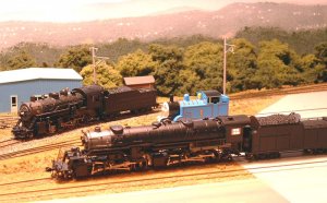

My freelanced railroad is a modern-era all-diesel operation hauling mainly unit trains and intermodal traffic.
However I just couldn't resist these two steam offerings by Bachmann and Life Like.
They are both little gems, run smoothly and quietly and have beautiful detailing.
At least I have the excuse that these old steamers are on my railroad as "preserved excursion" trains.
If you operate a steam-era layout it is a little more difficult to explain away an SD90MAC outside the roundhouse!!!

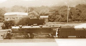

I edited this shot in Photoshop to make it look more "steam-era"

Hi Gavin , the Lifelike Y3 looks great , althought i am a avid HO modeler i am very tempted , do they run as well as they look.I dropped into Stanbridges but couldn't see any , is PHC the only place thats got them?

Thanks Gavin , love the pictures as well , the first is even my new wallpaper on my PCreen.I check out PHC tomorrow and see if any are left.
That pulling power is fine by me saves borrowing to many cars from the people

Gavin,
Those steamers look just fine on your layout. Everyone needs at least one to keep the sinuses clear.:) Don't fret about the pulling power. It gives you twice as much operating enjoyment doing a second trip.:D :D

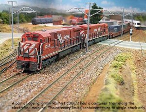

Gavin
I just have to say your railroad is a true inspiration for me.
(I was going to sell my Kato C30-7.. but seeing yours has made
me decide to stay my hand).
The Steam locomotives look great too, thanks very much for
sharing these photo's with us :) :)

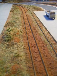

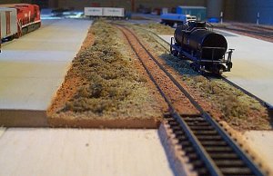

Here's how I model "buried" track, either overgrown industrial sidings or tracks buried in "concrete" (eg on a wharf).
My module benchwork is built out of balsa wood.
To bring the level of the terrain up to sleeper (tie) height, I first glue down a thin sheet of balsa (about the same thickness as the cork underlay). Then I scatter scenic material over the sleepers and the "raised" terrain surface. In this way, the tracks look like poorly drained, poorly maintained, half buried industrial trackage (centre and right).
For my wharf area (left) I simply use a thicker sheet of balsa topped with sheet styrene (painted light grey). The combined thickness of the balsa/styrene sheets should be just shy of the railhead for ease of cleaning and operation.
Might be of use to someone planning something similar.

That's GREAT looking trackwork, Gavin!:cool:
As I get a little more experienced with N scale, I realize the challenge of getting N scale track to look that good.
I hope I can get to a point one day, that my N scale track can look as good as yours & Tysons!
