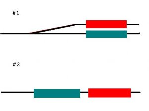

Josh, I am assuming that you plan on uncoupling cars by hand? With the short spurs and curves and such, it will be pretty difficult to get consistent uncoupling with magnets.
Another thought:
I did alot of research when I was designing my layout. One thing I read was the following, which I think you should consider.
Using the diagram below: Scenario #1 and Scenario #2 both can hold 2 cars. The first scenario has a turnout with all the added complication and expense. The second scenario is just a straight piece of track, simple and easy. But as I said, both will hold 2 cars. Using #2 will simplify your trackwork, save money, free up some space for industries, and make your switching of cars a little more interesting because you may have to pull a car out of the spur, set a new car in, then put the first car back where it was.
So instead of having two short little spurs behind the turn-out, you have the single spur serve two different industries.
There are a few places on your layout that may be candidates for this.
Nope, you got it right, I will be doing all the uncoupling by hand
That is some exellent advise Gary!!!! Thank-you, I will be editing some of my spurs, I see 3 right now and im sure there is at least a couple more in there that I can free up. It will save me money when it comes to trackwork!!! Thanks again for the advise, ill be changing those after im done posting Trainnuts idea :mrgreen:
