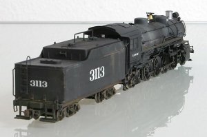

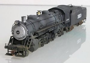

Nearly three months ago I started to convert my Trix Mikado from NYC to ATSF. I couldn’t finish it until now, because I had to wait three months for the decals to be delivered :curse: . I know, that I cannot turn the Trix Mikado into a real ATSF version, but if you just take a quick look and it looks like an ATSF class 3100 engine, it’s good enough for me.
To convert the engine, I removed the NYC lettering, painted the smoke box front and the smoke stack silver, replaced the bell and the headlight, added a number plate to the front of the smoke box and converted the tender from coal to oil. I weathered the loco to remove the shiny new look of the Trix Mike.

BTW, where did you get your detail parts?? What color did you use for the smoke box?? I specially like the subtle weathering...Great job...!!! :thumb:

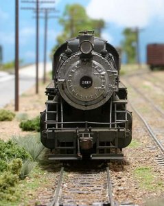

I want to see more pics of that beautiful mikado on the layout!

cn nutbar, your kind words about my Mike mean a lot to me as they come from a steam connoisseur :wave: . Gus, thank you for your nice comment. The detail parts are made by Cal Scale. I ordered them from Walthers. I used Revell airbrush paints. I mixed two shades of grey for the boiler and the color for the smoke box front and smoke stack is alluminium. Steve, thank you once again. I would like to show some more pics of the Mikado on my layout, but I have to do some work on the layout first. After all the work on my engines and the turntable I have to (scratch)build some structures for the layout now.
Very nice conversion job, Kurt. I'm not familiar with the prototype, but the work you did on the tender alone says "Santa Fe" (all the way), and the weathering ties it all together very nicely.:thumb: :thumb:

It looks great Kurt. The 3100's were closer to a heavy mike than the light mike. I think Rivarossi made a model of the 3100 series in ho scale. The light mike is very close to the Santa Fe #1798 & #1799. It was a small class of only 2 units. The most significant spotting difference I've seen between the #1798 and the USRA light mike is the air pump mounted on the left side of the engine is mounted just below the walkway, so that the walkway is flat from cab to pilot. On the Santa Fe engine the air compressor is mounted about halfway up the walkway, and the walkway ends on one side of the air compressor, steps up over the top of the compressor, and then steps back down to the original level once past the compressor. I have an Athearn Genesis USRA mike that I'm going to paint as #1798. It is close enough to suit me so I won't worry if a rivet counter shows me where it isn't right, and I'm not going to try to move the air pump either!
