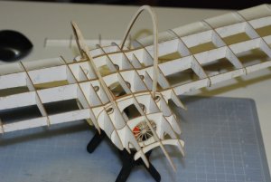

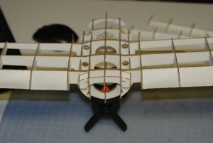

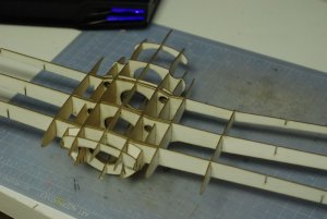

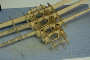

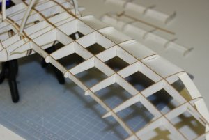

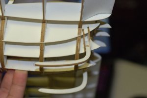

Got my laser cut today. The cut was beautiful! But, I made a big boo boo. The illustration board I picked was just a little thicker then the 1mm I need, so the fit was very very tight. It took brute force to put the fuselage together, so I didn't even try to put everything else on cause I will just end up breaking all the small parts. Going have to go back to art supply store to get a new board and then order a new cut next week. But, still I was very happy to see the fuselage frame was a lot stronger then I expected

You might want to pick up a set of machinists files. These will allow you to easily remove any excess stock and turn a tight fit into an advantage. I would also pickup a set of vernier calipers. This way you can measure the material down to .001" of an inch. The are relatively inexpensive. Personally, I would not discard this frame, if you take the same amount of stock on each side of the part, they will be centered so the oversize will not be an issue. I have a set of Nicholson files almost 30 years old. These cost around $30 dollars, but well worth every penny!
http://www.amazon.com/Nicholson-Piece-Hobby-Carded-Length/dp/B00002N5JT/ref=pd_sbs_indust_6
The frame looks magnificent!! As does the design. You are kicking butt, again! :)
I have always liked Brown and Sharp tools, Starrett, and Mitutoyo, but these are for a machine shop and you can get a set of calipers for $39 dollars from Amazon (link below) that will serve you will, without breaking the bank. The digital ones can go from SAE to Metric. That's always nice. I recommend the ones below because the have the ability to read as a depth gauge. This is a very useful tool that you will wonder how you did without (if you don't have a set already).
http://www.amazon.com/dp/B005002TS6...&hvpone=&hvptwo=&hvqmt=&ref=asc_df_B005002TS6

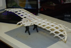

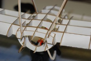

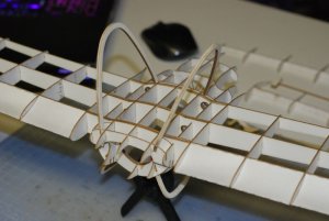

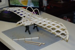

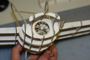

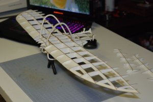

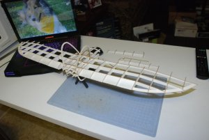

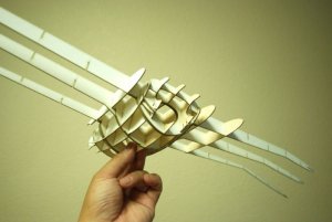

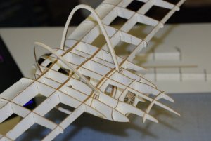

Took the frame design to the laser cutter this morning and got it back in afternoon. Not only they did a bang up job for me, they give me discount by not charging me the someday service rush feed . The laser cut frame went together perfectly, if I have to cut that by hand layer by layer, that would take me weeks to build that.

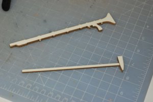

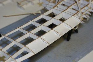

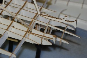

Couple things still need attention. First is the wing tip edge that don't need to break that up to 3 sections like it is now. Second, I think I should drop the triangle leading edge, don't think I really need it or make them like the wing tip edge.

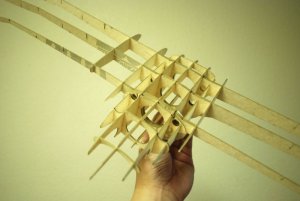

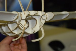

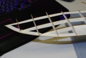

Last, think I should reposition the aileron ribs. It is ok as is, but think I can reposition the ribs better to make it functional.

That wing has one of the most graceful organic curves to it! I bet you could make one of the best bird models ever made. Elegantly wonderful.

I have one question: what kind of material is the frame? Is that some kind of cardboard? if so I guess the weapons can be sanded to make them smooth.

Hey, thanks guys. The frame cut from Crecent illustration board 300.6 cold press 20"x30", medium weight .50-.60. Cost $6.50. each at the local art supply store. There are board that cost less, but it was the only white board that thick. The board is .052" (1.32mm) thick. My design was .04" so I have to resized all the lap joints to .052"(I can't find any true 1mm board anywhere, all are 1.3 ~1.5). I don't think the thicker board will post any problem to the skin, I do have .015~.02 of space to play with. But true will be told when I start laying the skin. The frame do looks like it can fly. Actually, if one can find a fan motor small and prayerful enough to drop inside, I'm sure it can fly.
