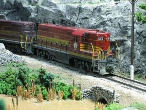

When we think of modelling mountains on our railroads, we don't usually model the entire mountain (just think of the scale involved) so we typically model a smaller portion.
On my layout, I've modelled a rock cut through a smaller mountainous region and the method I've used is to stack styrofoam (blue or pink) and carve it to the general shape of the hillside. For the rock faces, I mix up a solution of Plaster of Paris and spatula it on to the styrofoam. After it hardens, I use my e-xacto blades to carve striations in the rock or any other outcrops. I also use the flat bladed chisel for some of my carving.
This is one of many methods that can be utilized. Good luck with your endeavour.
Check out the image below and you'll see Marshall Cut on my layout.

WOW thats looks really awesome, maybe one day i will make one look like that :thumb: . what color paint did you use? and do you spray paint it on, or brush it on? thanks for all the help

Not only nice looking rocks, but the total scene is really nice. I especially like that rock culvert, and that B&M paint scheme certainly doesn't detract from the scene.

Thanks fellas for the compliments on the scene. As for the paint...real simple! After the plaster dried I applied a wash of watered-down black with a few touches of brown. This "brought out" the details I had shaped and carved. The talus at the foot of the cut, if I recall, was left over plaster after carving. The rock culvert is a Woodland Scenics offering that was also given a wash to snap out the detailing in the rock.
Marshall Cut is named after my good friend, Trevor Marshall, a cherished member of our Friday Night Group who has since relocated to Toronto.
I agree with you Wayne...I'm glad the B&M chose to apply the EMD-inspired striping of gold against maroon on it geeps as well as those renowned F's.

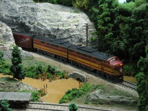

Hi Miles. Yes, that was my layout on the cover and lead article. It was a big thrill, for sure! I was also in the Model Railroad Planning 2001 issue where I discussed my surround staging concept.
I've decided to throw in this picture to show a more distant shot of the rock cut for our friend who was asking about making realistic mountains. After weathering the rock, I then added ground foam along rock ledges and planted the odd tree here and there. I find that achieving a balance between the greyness of the rocks and the green of the foliage helps produce a finer scene.
Oh yeah, that's B&M FT4217 exiting Marshall Cut. I numbered the unit after a photograph a friend had taken well over 50 years ago of the same unit while he was working for the Boston and Maine.
Indeed, sentimental reasons are great launching pads for all aspects of this great hobby! :) :) :)
