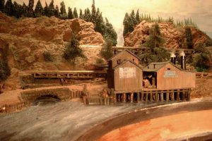

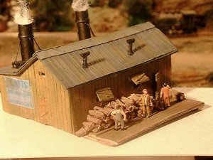

Wickman ....Lynn , started this layout (its really a big Diorama , I like building scenery more than running trains ) determined to use no commercial materials other than track and rolling stock so each and everthing is scratch built, those buildings are hand cut

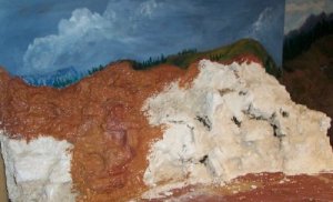

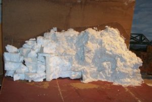

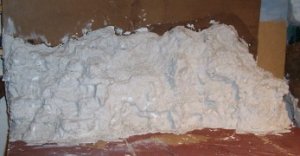

For Steamhead ...and others...Rocks
Gus the attached are not the rock formation as shown in the photo of Catts Fish Ind. but this is how I go about it
My rocks are lumps of polly stirene ( packing from the computer shop )
glued together and held with tooth picks
Then a coating of Dry wall plaster is applied ,if you mix the plaster with water that has been mixed with dishwasher liqued it slows the drying process and the you can carve strata , I use a stiff bristle brush to stipple the rocks to avoid that flat smooth plaster look, apply a coat of flat white paint and then coulor with the shade of rocks you want to depict
The photos are of my Coal mine diorama which I did in a rather hurry

Hi Jimmy...Thanks for the pics. That gives me a pretty good idea of how to go about doing this. The plaster that you use is that the pre-mixed type, or is it dry, and you mix it with water..?? I really appreciate your help. Thanks.
jimmybeersa
May 15, 2001
508
91
Alberton . South Africa
Gus its dry power ,Called Rhinocrete here its ordinary drywalling plaster,
put the water in first and then add the powder so this way you can control the consitancy of the mix I sometimes add bits of pollystyrene after I have plastered to make projecting rocks and then plaster over them
