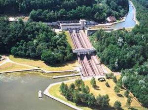

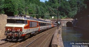

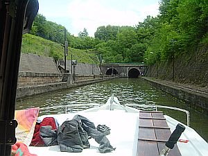

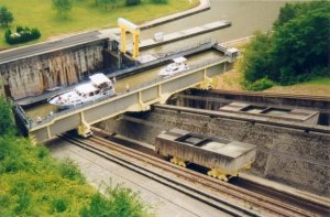

Rivers crossing rivers, wheels lifting ships... Interurbans post brought back memories of a trip to France two years ago.
In France there are lots of waterways and canals which are both used by freight ships and tourist boats. Near St. Louis-Arzviller there are a few engineering tidbits along the Rhine-Marne canal system.
Most spectacular ist the Arzviller ship-elevator, which lifts or descends ships: A concrete trough which carries up to two fairly big ships is transported sideways by a cableway up and down a steep (41%) slope. Height difference is 45 meters (about 135 ft). The whole thing replaces 17 locks!
The 'ship cable car' is balanced by heavy counterweights in the form of steel/concrete slugs on rails. It doesn't even need a motor. When the trough is at the top, it is filled with a little more water, so it is heavier than the counterweights. At the bottom it spills so much water, that the counterweights are heavier and pull the trough up again! Ingenious! :thumb:
Ron
Pics 1+2 - general overview / 3 - the trough with ships going down / 4 - The carriage below the water trough

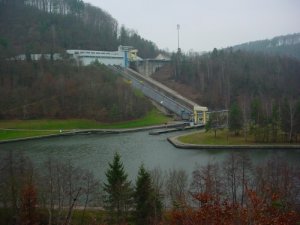

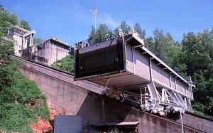

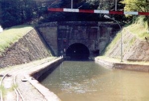

Through the mountains by ship!
Along the same canal you find another curiosity: Waterway tunnels!
The most spectacular is the Arzviller tunnel with a railroad tunnel running parallel to the canal tunnel. Amazing!
Along the canal you still see the rails of small towing locos (or horses) which used to pull the barges until 50plus years ago...
Ron
In pic 2 you see literally the light at the end of the tunnel :D :D :D
Pics 3+4: The Arzviller double railroad-canal-tunnel
