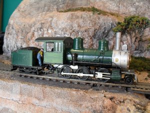

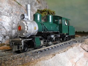

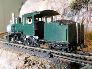

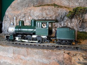

I am currently kit bashing a Bachmann "Bumble Bee" Mogul (hated that yellow!) to a backwoods 2-6-0, with an ultra-short tender.
I needed to do this in order to get the thang to fit on my short turntable.
The main areas of extra length were the 'limousine' tender, and the extended pilot, both of which I dispensed with. I then made up my own short pilot, and fitted a stubby tender which started life as the fuel bunker on my old Forney.
It is still a Mogul, and is far from complete, but here's a few pix:
