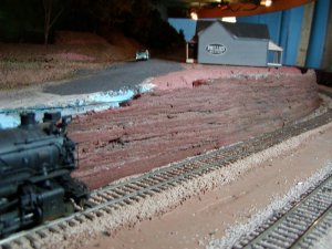

Have you seen the article in the Sept. MR on using ceiling tile to model rock? I've done something similar using leftover scraps of homasote. I'm not all that happy with the painting, it needs some highlights, but I think it compares favorably with the photos in the article. The scene, as just about all of the scenes on my layout, is incomplete. I tend to flit from one area to another, never completing aone. No discipline. Well, who needs discipline in their hobby!

Hey there Gary,
I've done the same thing with homosote scraps and think it makes some convincing cliffs and rock cuts. I usually smear joint compound or spackle over the homosote and then, after it dries, carve some more strata and then tint it with grey paints. That seems to help with coloring and highlighting. I'll have to check that issue of MR.

Gary,
That looks fine to me! :cool: Touch it up around the edges with some grass etc, and you'll have some mighty fine looking rock. I find that, when you do something like that, it doesn't necessarily look right at first, but as you surround it with appropriate stuff, vegetation, finishing touches, it does, then look quite good. Completely different to the "half done" look.

Thanks for the kind words guys. I think some subtle drybrushing of white applied vertically from top down will add contrast. Woodie is probably right, adding dirt and weeds to more nearly complete the scene may be just what it needs to look better. Perhaps I can get that done in the next month or so.

Hi Gary, I think the "rocks" look just fine:) You know, that idea of using broken ceiling tiles for rocks has been around for ages...I guess "what goes around comes around":D :D :D
Something else ( another real old technique) that will make some interesting rock strata is to stack pieces of pine bark on top of each other. A 40# bag of the stuff is only a couple of bucks at the garden center. Pick out the big thick pieces for your rocks and put the rest around your petunias:D :D :D

I've thought about using this technique, only with foam supermarket "meat platters" or whatever you call them. In N-scale, this would give much thinner, i.e. more-to-scale, strata thicknesses. Any comments?

Thanks Vic, Yeah, I've heard of both methods for many years, While I've used the homasote method a few times over the years, I never did try the pine bark. One thing I was concerned about was wildlife. I suppose a few minutes in an oven would take care of that, not sure if the drying action would make the bark crumble. Spraying with insecticide would smell. Have you used it?

Bill, If I'm thinking of the same thing you are, I would think the stacked trays would result in too perfect strata. Never having tried, I can't say for sure, but I think attempts to use blades or wire brush to change that would simply break the material. I don't think there is anything scale specific about the homasote or tile method, I glued several thicknesses together and used a utility knife to gouge them. I went at it for quite a while. Occasionally used needle nose pliers to pull some loosened material out. Most tedious step was using needlenose pliers and tweezers to remove the "pilling". But if this isn't done, the rocks won't look right, in fact they won't look like rock!

Hi Gary, Yes I have used it but not on my current layout. We used it on the club layout some time ago and didn't have any problem with any "critters or crawlies":D :D Don't know about putting it in the oven but we did let it "air dry" for a few days because some of it was damp. We glued the stacks together with a hot glue gun.

Gary, a few dabs of colour for highlighting and you got yourself a great cutting!

In my opinion you've done a fine job, looks quite realistic to me. I'll be happy if mine turn out nearly that good..
