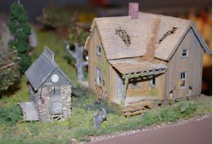

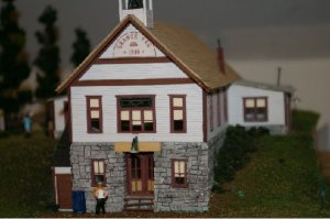

It doesn't say what the material is. Is it plastic or plaster? I love building craftsman kits. I typically use a base-coat of paint that is a little lighter than the finished color. In this case a beige, let's say, for the stucco. Then from there I use washes of highly diluted paint (in several applications) to sneak up on the final color. The washes will vary by what area you're modeling. Artist acrylics work well. I typically use greys and blacks. The important thing to remember is to start light, then work your washes darker. You can't go lighter.
