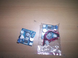

Yee haa , i finally got my step down volt regulator & it's very small it is only 37mm x 37mm. great sizes for my Normandy. Now all i have to get is the transformer to power up this beaut.

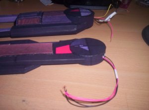

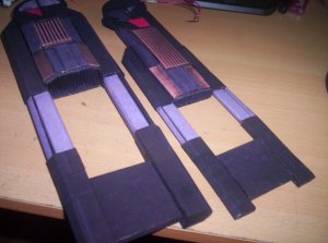

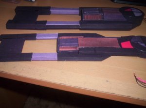

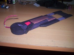

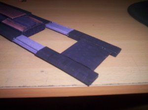

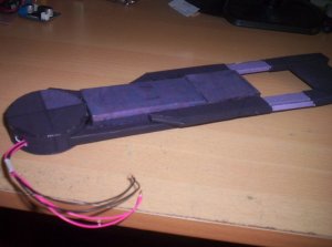

Complete finished of left back engine
Here she is the complete back of the left side engine finished. the fun part was aligning the back engine flaps dead straight while the glue dries.hehe.all it needs is a little touch up here & there then she is all good.:mrgreen:
I'm just starting to assemble the back left lower wing now but i'll build it to 85% so i can feed the wires through easily with out problems & setup the white lights when it arrives here soon.

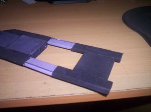

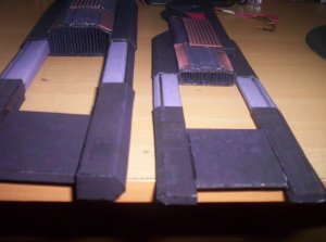

More pics.

Normandy SR1 Update : the transformer i'll be using for this is a 15v at 4amps pack unit. i'll feed the 15v in both of the step down voltage regulator. these voltage regulator can handle from 1.5v to 18v max at 3amps input.Feeding both voltage regulator with the 15v at 4amps transformer it will divide the 15v at 4A in half. The first of the voltage regulator is coming out 5v at 2amps for the Arduino UNO SMD Version programmer , then the second voltage regulator is coming out 12v 2amps for one set of the engine glow. the other half of the engine glow blue lights is going to be programmed at a slow motion pace of flashing on the Arduino UNO programmer.
