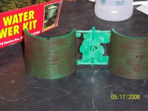

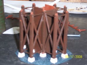

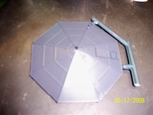

Here's what I have done so far. I apologize for the quality of the pictures. I don't think my camera is made for close ups. I still haven't attempted airbrushing.
Looked better after the 2nd coat.
The tank only has one coat. I'm not sure if I want to try a 2nd coat or try the airbrush.
Sometimes the coverage of the first coat leaves a lot to be desired. However, it's often just enough that the second coat will cover well - as if you'd used a primer. Some of the colours in the old Polly S line of paints were like this.
Another way to get better coverage is to apply a primer first. I use Floquil paints, and like their Grey Primer. Any flat, grey paint would probably work, though, and you can get primer in spray cans. You could primer the tank by spraying or airbrushing, then paint the final colour by brush or with your airbrush. Regardless of which you choose, I'd suggest cementing the tank halves together before painting - that way, the paint can better hide the joints.
