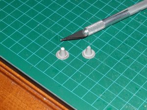

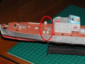

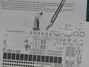

Long ago there was a nice collection of models on the BTCAD site. I had downloaded many of them, and last fall I started building a ship model from there. The site is no longer alive, but a few months ago I did find them in the wayback machine.
I started the ship just to do something different from all the aircraft and spacecraft stuff I usually do. The model, at a scale of 1/72 is finely detailed, with A LOT of very small parts. It's by far the most challenging model I've done so far, and I'm enjoying it so much i decided to start a thread on it.
So, first off, I've attached a picture of the model from a few months back.
The second picture shows the parts I'm working on now. These are, I believe, ventilation funnels. You can see how small they are. The third picture shows one of the base cylinders (part 40a visible in the second picture) rolled on a straightened, standard paper clip. These puppies are tiny, and there are ten of these to build! Each funnel assembly actually consists of three pieces. Parts 40 and 40a that you can see above, and there is a small (about 1/16 inch) circular piece on a different sheet that forms the back of the funnel.
Later I'll post a picture of the model as it is now. It's such fine, tedious work that I've been building other stuff in between when I need a break. I posted some pics of those projects to the gallery for anyone that's interested.
Can any of you experienced ship builders tell me how to prevent the indentations from showing between the formers? I'd like to be able to improve on that the next time I build a ship.

Indentations between fromers can be reduced by doubling the thickness of teh deck and side panels. I use 190gsm card stock. A glue stick is good for laminating the sheets of card.
On a recent model that was a bit larger than the one you are woking on - a full hull - I tried out the expanding foam that builders use to stop gaps. It swells up in an alarming way, but then can be pared back with a hobby knife and sanded. That produced a good result, and I will use it again next time.
Also check out David Hathaway's suggestion for making railings from cotton thread - see papershipwright.co.uk - a model ship never looks complete until it has its handrails and rigging
Regards, ronC

You can also glue horizontal stringers between the bulkheads to keep the paper from warping inward.
I've even seen builds where styrofoam was added in between the stringers and sanded into the hull shape before adding the hull skin.

Floral foam works well. It's really messy though. It has a fine "grain" and sands down easily but it gets everywhere.

I imagine the styrofoam could get messy, but I'll keep this in mind as another option though. I've been reading up on instructables about hot-wire foam cutters, and I plan on making myself one. I could try using the former pieces as a pattern to cut the foam pieces, and the hot wire cutter would eliminate a lot of the mess.

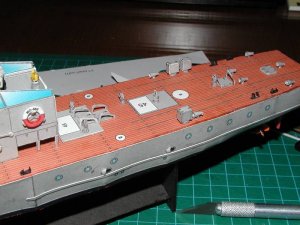

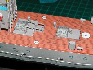

Latest updates
Not too much to report since the last update. As mentioned all of the funnels are on, then I moved on to the second type of funnel, and some storage boxes around the deck. I'm building the light hatches now. The attached photos show all the flaws, er, I mean details of my work. Also a couple pics of the things that have been distracting me - experimenting with other techniques and media.
Enjoy,
SJ

Squirrel-meister: What you see as "flaws" now are teaching points for the next model that you build. As far as I can see, you are doing very well!! DO NOT BE YOUR HARSHEST CRITIC!!
I don't know how many card models that you have built before this one, but you are doing a fine job with it; as it is more than a little complex.
Just FYI: The "funnels" are ventilators for the below-deck spaces. The "boxes" are exactly that: ammo boxes for the fore and aft heavy machine guns (HMG), probably 12.7 mm or 14 mm. If the boat got really lucky, it may have had a 20 mm cannon on the foredeck.
The major weakness of the MO* class was that they did not carry torpedoes. This was later rectified.
Carry on and finish the model!
The price is right, and you are doing OK!

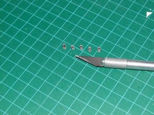

A little progress
I installed the two light hatches and have started on the two main deck guns. Haven't had much time for modelling lately so not much progress. Here are the light hatches (small fit problem with the base of those not matching the top parts) and the base of the deck guns.
By the way, I keep forgetting to mention that I translated the instructions (which are in Russian) using Google translator, and have updated and refined the translation as I work along. If anyone wants a copy let me know and I'll email the document (it's in MS Word format).
