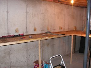

Some of you may already know that I am building a temporary layout. It is not going to much more than a "plywood central". I will work on some structures for it, but most will be cardboard boxes.
After surgery and recovery I will shift into a more permanent layout.
Here are some progress photos:

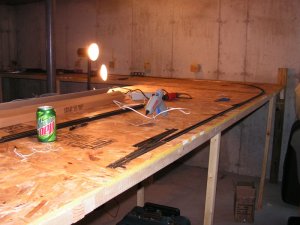

That's it! Keep up the good work. What do you have planned for the bridge in the second photo? I see you've cut away a space for a ravine or river.

Ralph, That cut out is going to be a river. I have to shape the edges a bit yet though. The bridge will eventually be replaced with a scratchbuilt truss bridge. For now that $3 atlas kit gets the job done.

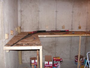

SgtCarl, the benchwork is supported along the concrete wall with blocks of 4x4 attached with a ramset. The rest of it is supported by 2x2's. You are more than welcome to use the design.

Looking at your pictures, I think you should pick up some 1x3 or 1x4 lumber. It looks like you are currently using 1x2 lumber for your framing. I would cut the benchwork sections into 4 foot lengths. I would remove the 1x2 framing and save it for making the short pieces to make the "boxes" for shipping. Make new frame work with 1x3 or 1x4 lumber which will be stronger without adding much weight. 1x2's are perfectly adequate for any cross members, so you don't need to replace cross members with larger lumber. From experience, I can tell you that putting in multiple joiners tracks for a yard is a real pain. If you have any sections where you have a bunch of yard tracks crossing the joint, instead of using joiners, cut a gap in the rails right at the bench work joint. When you pack it up, cut some plywood ends to bolt the 2 sections together and protect the ends of the rails from damage for the move.

Good eye Russ. It is actually 2x2 but without having a picture of the other aspect it would have been hard to tell that.
The pics are outdated as I took all of the track apart so I could put down a poly sub-roadbed. I have not put any of the track back down as of yet.
