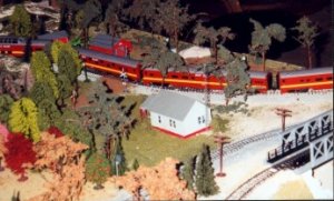

I agree with Bill on this one. I use all flex track on straight aways. I use curved sections on my turns. The local model club has told me, "Use the largest turning raduis as possible."
Cab you believe that I have 18" curved track at an "S" turn? Make things even more complex, I run my IHC passenger cars on it!!!:eek:
