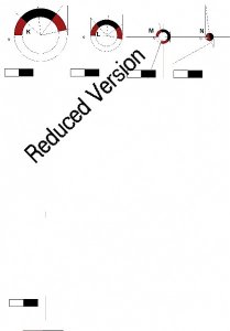

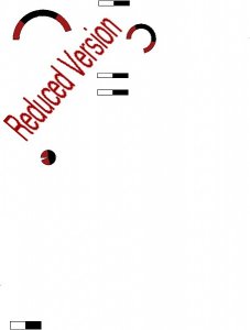

Then using Excel and Word I did two versions of the bow: one elliptic and one parabolic.
Finally I selected the parabolic one, and the result is good for me.
If someone likes to receive the pdf of the parabolic or elliptic, PM to me the email address. Sorry for the roughness, but I didn't think to publish them.

Some note for the guys who ask me the PDF:
I did the two versions not for publish them but for my own use, so they are very rough (see below a reduced version). There isn't any tab to connect the sections each other, so You have to do them by Your self. The black and white rectangles are useful to verify the correct scale when printed. Their lenght in total is 2 cm.
I'm in contact with Krzychu74, the author of the Skipjack, and may be he will kindly publish the two bows as detached parts of his submarine.

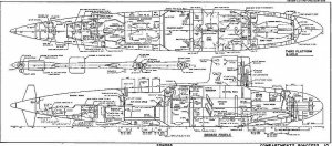

Below the original drawing I used to design my bows.
